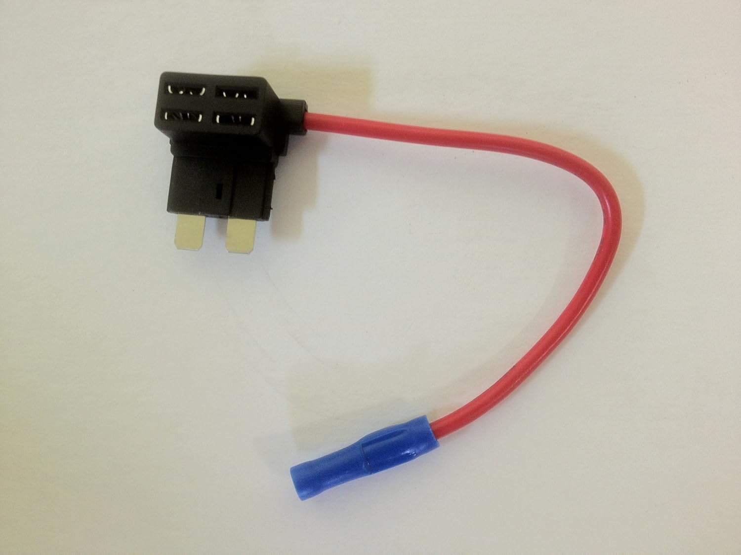

If you need a new power supply there is an easier way. In most fuse boxes there are at least a couple of spare unused fuse sockets that are already powered up as permanently live and as ignition switched live. If you don't have a circuit tester then make your own with a 12 volt bulb, bulb holder, 2 pieces of wire and a couple of mini crocodile clips.
Use your circuit tester to determine which sockets have a live supply. Clip one end to a suitable earthing point and the other to a small screwdriver and probe the empty sockets (its usually the top half of the socket that will have the powered terminal).
When you've found a powered socket buy a piggy back fuse connector ....
Insert the piggy back connector in to the socket and insert a fuse of the required rating in to the piggy back connector. Crimp on your device to the +ve lead on to the new supply and done. The piggy back connectors are available for full and mini size fuses.
