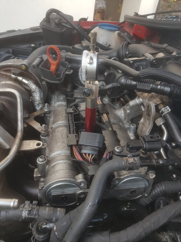

Re: 1.4 TSI 160 non starter advice
Hi there, thanks for the reply, appreciate it! I timed it with a dial gauge and the cam locking tool, I rechecked it yesterday to make triple sure (I used cyl 4 to find tdc when verifying as easier access, but when I originally timed it I used cyl 1!)

Given the issue seemed to carry over from prior to after the engine work, my working assumption is that the engine itself is not preventing it starting...
